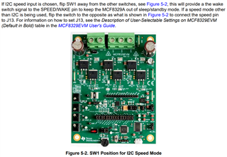

Dear team,
In order to control the motor speed with I2C communication of GUI on EVM board,
I need to set R47 to 25kΩ so that 3.3V is applied to POT(DACOUT/SOx/SPEED_ANA) Pin.
Can you tell me why?
Dear team,
Hi John Lee,
Speed pin used for entering / exiting stanby or sleep condition in I2C mode.
When speed pin is low and if device is standby mode then even if there is speed command through I2C device will remain in stanby.
Thanks and Best Regards
Venkatadri S
