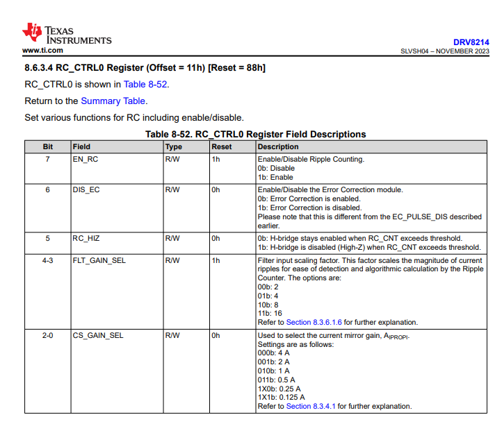

Dear team,
Does EVM have capability to stop the output when reaching the counted pulse threshold?
I know the IC does not have this capability and just flag the nFault or CNT_DONE register. We also found the function it can reverse but could not find that function.
Yuto
  • Hi Kitamura-san,
    The IC has the capability to stop output. Refer to the register RC_HIZ. It can Hi-Z the H-bridges when RC_CNT exceeds threshold.
    Setting this register to 1b will solve the problem. Let me know if I misunderstood and you were referring to something else when you mentioned 'stop output'.
    Karan
