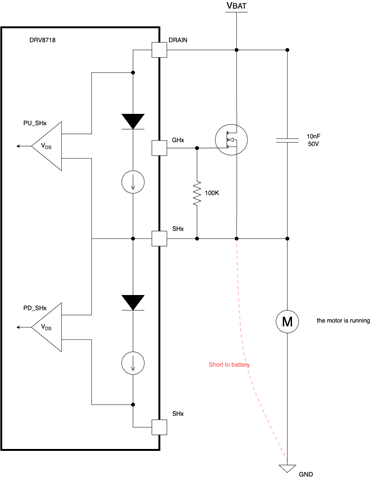

DRV8718-Q1: Online OSC detection and OTSD Fault
Part Number: DRV8718-Q1
When the motor is running, I try to create a short circuit to the electrical fault. I expect feedback VDS fault, but actually the OTSD fault is reported. I tried to clear the problem with CLR_FLT, but it didn't work. Then I power off and restart, the OSTD fault is still there. So I want to know the principle of OTSD, and I hope the experts can give me offer some suggestions to solve the problem.
