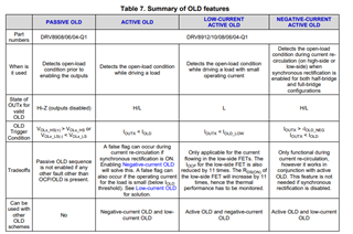

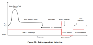

    I apologize for the delayed response. I was able to resolve the issue by latching the nSLEEP pin to high status again. However, I have another question I would appreciate your insight on.
    Is the OLD detection mechanism used for controlling the relay? I have connected the relay to the HS OUT1 signal, and the driver is reporting an OLD fault.
    I would be grateful for any guidance you can provide on this matter.
    Best regards
  • Hi
    Thank you for your question and update. Could you generate new E2E post for new question? This post will be referred in future, so would like to move new post for new question. Our team(including me) will support your new questions.
    I suggest to clarify how you connected load/relay .. Which OLD you are referring. In normal active OLD, if driving current is less than 9mA(typ), you will see OLD flag.FYI.
