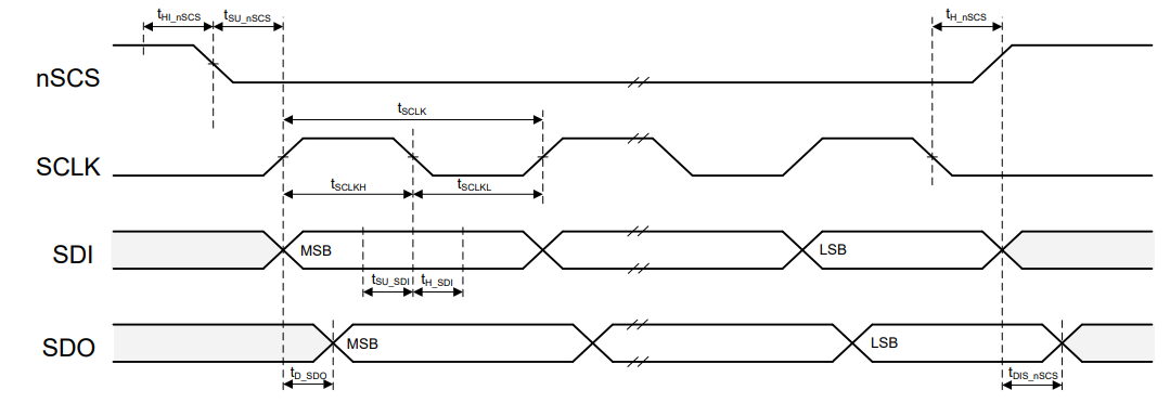

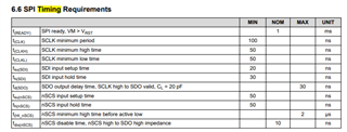

    2- Timing requirements.
    The SCLK pin must be low when the nSCS pin goes low and when the nSCS pin goes high.
    • The nSCS pin should be taken high for at least 500 ns between frames.
    • Full 16 SCLK cycles must occur.
    • Data is captured on the falling edge of the clock and data is driven on the rising edge of the clock.
    • If the data word sent to SDI pin is less than 16 bits or more than 16 bits, a frame error occurs and the data word is ignored.
    • For a write command, the existing data in the register being written to is shifted out on the SDO pin following the 8-bit command data.
    Please consider the following timing.

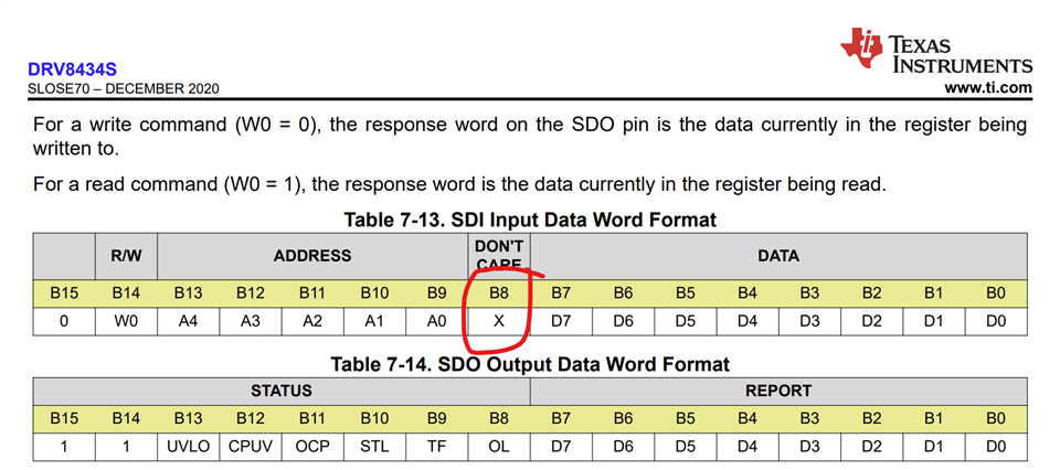

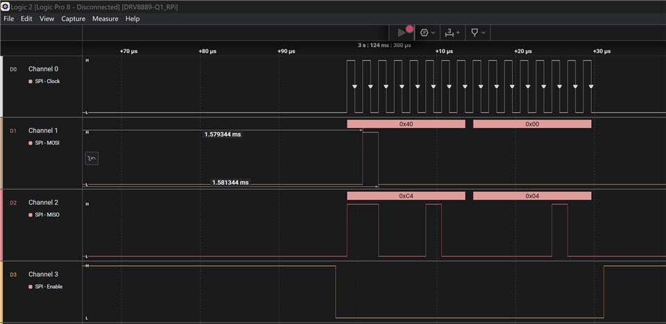

    This description looks correct. See below example of one frame SPI transaction capture of a read-only register.
    One important thing to verify is how you set the upper 8-bits for the address - see below. The address bits are left-shifted by one position in this device.
    Could you please capture all four SPI signals like the example shown. Thank you.
