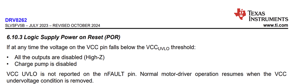

Hi Rayna,
1. SPI communication disconnect by accident
The device will continue to operate with the last know configuration used by the SPI. For example STEP input and DIR control works as expected with the microstep mode set by SPI before disconnect.
2. supply on VCC power off by accident
Please see below info from the datasheet. Thanks.
Regards, Murugavel
