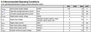

Hi team,
May I know if the DVDD and AREF are separate modules in the DRV8705H-Q1, which can be connected to different voltages, such as DVDD=3.3V, AREF=5V? Thanks.

Hi Ivy,
Thank you for your questions.
You can put different voltage on DVDD and AREF. DVDD is 3-5.5V, AREF is also 3-5.5.5V
