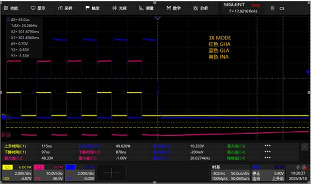

Yellow: INA, Blue:GLA, RED:GHA

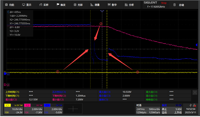

Fault figure 1:

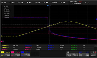

Fault Figure 2:

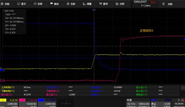

Normal figure 1:
As we can see in the fault figure, in very narrow pulse of INA, the GLA will short to ground in the falling edge, customer don't think is the negative voltage issue.
Please help to found the root cause.

    add failure process
    1. INA produce extremely high/low duty cycle, very short falling edge
    2.Once the gate pull down for 100nS, INA is turning to falling edge from the high signal, they see a up voltage spike.
    3.About 300nS, gate have another up voltage spike, and VGLS pull down to 2.5V and driver reports fault
    4.they test the driver pin, they found the low FET is short to ground
    they think is because the upper FET and lower FET open simultaneously in output driver stage and cause this failure.

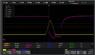

    Yellow: Phase voltage, blue:GLA, RED: VGLS

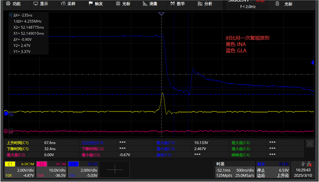

  • To be clear on the waveform requested, could the customer please provide GLx, INHx, VGLS together to help us validate our theory.

  • Hi Joseph,
    Please check below update waveform, measuring in the device pin.
    Yellow: INA, RED: GLA MOS side BLUE:GLA device side

  • Hi Joseph,
    Thank you for your answer.
    But As we can see from the waveform that test GLA near the device, there are not voltage violation of low side gate output pin.
    So, what is the root cause caused damage here?
    Thank you,
    Yishan Chen
  • Hi Yishan,
    Thank you for providing the voltage near the device.
    The issue here is that the input pulse is too short, which could be causing upper and lower FET to be on simultaneously like you suspected.
    The solution here is to set a minimum time on input pulse to protect the device and ensure correct operation.
    The shortest input pulse needs to be longer than the dead time by about 20-30% to ensure safe operation.
