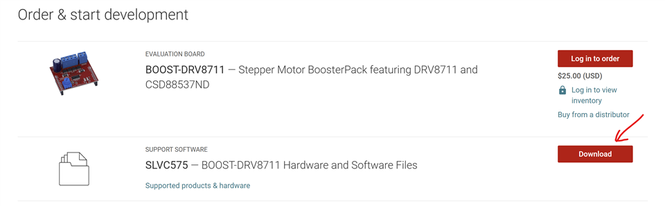

Additionally, we are trying to locate the BOOST-DRV8711 GUI application and its example source code for reference, but we have been unable to find them. Kindly guide us in resolving these issues.

    The BOOST-DRV8711 GUI application and its example source code can be downloaded from its webpage, https://www.ti.com/tool/BOOST-DRV8711. See below snippet.

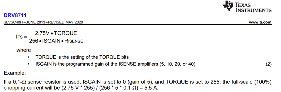

    The BOOST-DRV8711 uses RIsense value of 0.05 Ω. This would set the IFS current to 5.5 A. The 57HS112-4204 stepper is specified for 4.2 A IFS. The IFS can be reduced to close to ~ 4 A by changing TORQUE register value from 255 to 190.
