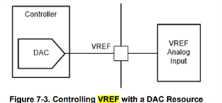

2. I would like to know the specifications required to supply to the VREF pin.
I am considering whether it is possible to supply VREF of 30 drivers from one DAC.
    The current regulation set point is adjusted by the voltage at the VREF pin. The Vref is utilized to set the full-scale current for the drivers based on the Kv: Transimpedance gain by  IFS (A) = VREF (V) / KV (V/A)
    As long as all devices have the same full-scale settings, it is fine use the same DAC for the drivers.
    The full-scale output current may need to be changed between many different values, depending on motor speed and loading. The voltage of the VREF pin can be adjusted in the system to change the full-scale current. In this mode of operation, as the DAC voltage increases, the full-scale regulation current increases as well. For proper operation, the output of the DAC should not rise above 3 V. Based on the bench test results the Vref current is about 20uA for each device.

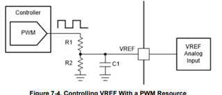

    The VREF pin can also be adjusted using a PWM signal and low-pass filter.
