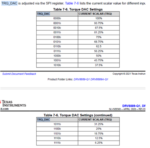

    2. TRQ_DAC is dynamic. the max value = 15 , the min value = 10
       1. What are the possible OL bit  be set except current less than 30mA?

    TRQ_DAC setting will not influence OL detection as long as every step or microstep current is > 30 mA.

    With VREF = 2.14 V and TRQ_DAC = 15 (6.25 %), the current amplitude would be ~ 60 mA. Which means with 1/8 uSteps depending on where the motor is stopped the current can go below the OL threshold of 30 mA. Lowest current would be 60/8 = 7.5 mA, Only after four steps from the lowest current the value would be > 30 mA. Assuming the TRQ_DAC = 15 was used for hold current.
    While running with TRQ_DAC = 10 (37.5 %) the amplitude would be 365 mA, lowest current would be 365/8 = 45.6 mA which would be > 30 mA.
