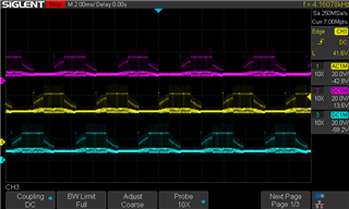

    Could you share some waveforms of the output phase current? Want to understand what is exactly causing the LOSS_OF_SYNC. Also, what is the acceleration rate you are targeting?

  • Hello Sachin,
    Could you help me understand how to check the output phase current on the MCT8329EVM? Also, our acceleration rate is around 2–3 ms, which is what we are expecting. What would be the best approach for measuring or monitoring the phase current waveform?
    If you have an oscilloscope and a current probe, you can probe the current through one of the phase windings (one of the three wires connecting the motor to the EVM).

  • Hi Sachin,
    We currently don’t have current probes, but we do have a differential probe. What would you suggest in this case? If needed, we can provide voltage measurements for all three phases.
    We have attached the waveform using voltage for reference.
    Regarding acceleration, for initial startup, a lower acceleration rate is acceptable. However, after startup, we require a faster response rate for varying speed, as our application is for a drone. Do you have any recommendations on optimizing this behavior?
