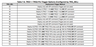

I want to trigger the deployment using TRG1 and TRG2 pin.
1. How to select deployment current and deployment time of TRG1 and TRG2
2. How to configure deployment rate for TRG1 and TRG2?
3. Can TRG1 and TRG2 deployment current and time be different? Let’s say I want 1.2A for 2ms if there is a valid TRG1 and 1.75A for 0.5ms if there is a valid TRG2 is it possible to configure like this?
