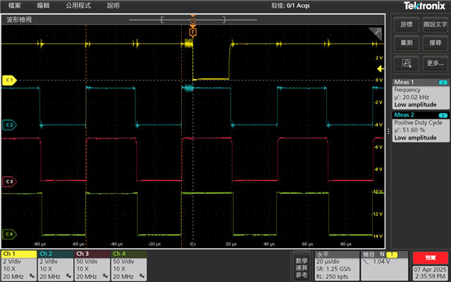

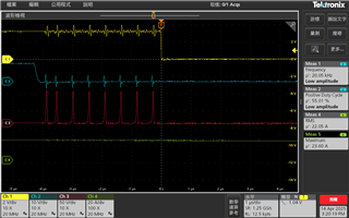

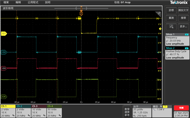

  • Hi Joseph,
    Sorry to have kept you waiting so long.
    Please refer to the waveform below.
    C1: nFAULT, C2: INLA, C3: GLA, C4: SHA
     pic.1
    C1: nFAULT, C2: INHA, C3: GHA, C4: SHA
      pic.2
    Please let me know if you have other waveforms you would like to see.
  • Hi Sky,
    Thank you for sharing the waveforms.
    I'm thinking this is might be a VDS fault since you mention it occurs at high loading.
    Is it possible for you to change the resistor to set VDS pin to configure for higher VDS value?
    I would like to see if the issue still happens after this change.
    Thank you,
    Joseph

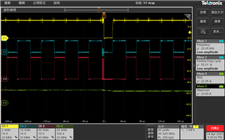

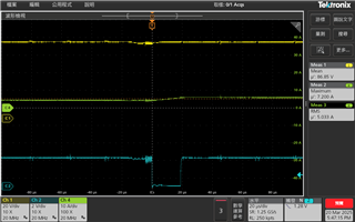

  • Hi Joseph,
    I only change Rshunt from 0.007 to 0.0035 ohm on EVM, and use fan for cooling to increase the power.
    When nFAULT is pulled-low, only the waveform of Vgsh of B phase is abnormal.
    VgslA/B/C and VglA/C are normal.
    C1: nFAULT, C2: Vgsl, C3: Vgsh, C4: Iphase
      (ZOOM IN)
    Then I add a 1000pF on GS side of six MOSFETs, loading can be increased about 20% .
    Then I increase VDS_OCP from 0.2V to 0.4V, the 20us FAULT does not show again.

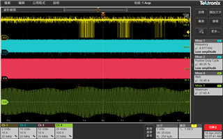

    It seems the VDS_OCP has been triggered, but I have two questions.
    1. According to the waveform below, Vds is only 0.11V and which is far from 0.2V.
    Is it possible to trigger the VDS_OCP?
    Vds = 27.6A (C4: Iphase_peak) x 4mohm (CSD19532Q5B Rdson) = 0.1104V
    2. If VDS_OCP has been triggered, why the pull-low time period is 20us instead of 8ms?
  • Hi Sky,
    Thank you for all the effort.
    1. This behavior makes sense. The RDSon value changes in relation to temperature. As the MOSFET heats up the RDSon value will increase which is why you cannot keep 4mohm as a constant value in this equation, and is also the reason why the VDS_OCP is being triggered
    2. The reason why it lasts 20us is because according to datasheet section 8.3.6.3:
    "The MOSFET VDS overcurrent protection operates in cycle-by-cycle (CBC) mode by default. This can be disabled on SPI device variants through the SPI registers. When in cycle-by-cycle (CBC) mode a new rising edge on the PWM inputs will clear an existing overcurrent fault."
    So as you can see from your waveforms, the new rising edge on the PWM input clears the fault. They line up directly
    Thank you,
    Joseph
  • Hi Joseph,
    Thanks for your answer for question 1.
    Regarding answer of question 2, the PWM period is 50us, why nFAULT does not recover at next high side turn on? And why high side turn on shortly for 8 times before nFAULT pull low?
  • Hi Sky,
    nFAULT recovers at next pwm input rising edge either high or low side turn on.
    I am not sure about the behavior of these pulses here. It is hard to tell without seeing inputs at this time as well.
