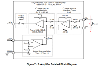

Hello team,
Is it ok to configure VAREF=5V and VDVDD=3.3V? Any risk because I am not sure if the sensing output will be connected to other internal blocks, or just output?
In low power mode, the VAREF=5V will be shut down, and VDVDD is still on, is it acceptable?
Thanks!
Daniel Wang
  • Hi Daniel,
    Thank you for your questions.
    VAREF=5Vand DVDD=3.3V is no problem.
    This is also no issue. AREF is used for current sense amp's offset adjustment.
