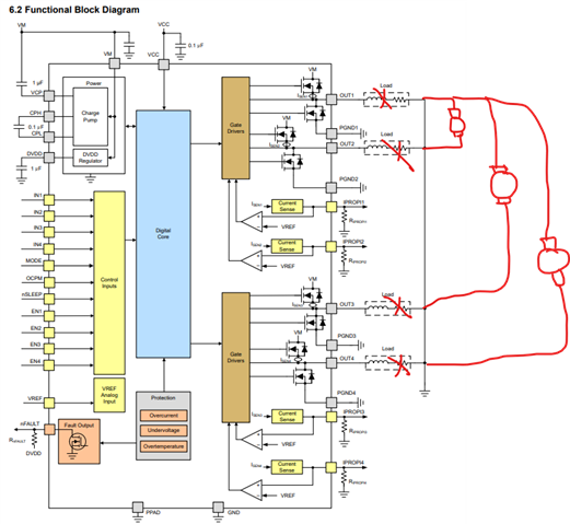

Is it possible to drive three motors like this way in the 48V system?

Are currently TI drivers available to connect three brushed motors in the 48V system?
I understood you do not have TI sales contact. Never mind.
DRV8962-Q1 has independent mode so can control each OUTPUT separately.
Your configuration could be possible.
regards
Shinya

Talking related toDRV8962-q1, is it Possible to connect three motors with specs (1A steady current and 3.45 stalling current) using this driver?
I am assuming only one motor spin at the same time. If stall 3.45A period is ~up to 1sec, should be OK.
