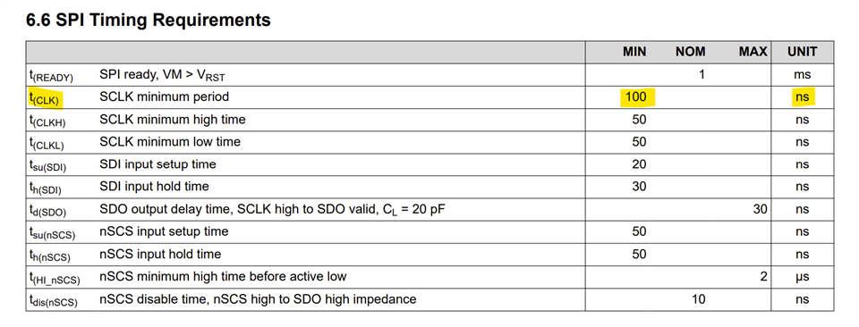

SPI is currently set to mode 1, that is, CPOL is 0, CPHA is 1, what is the communication frequency range of SPI?
    As per datasheet it can be up to 10 MHz SCLK. Typically applications use 1 or 2 MHz SCLK to minimize effects due to stray capacitances and glitches.
