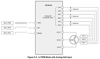

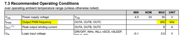

2.  For the PWM signal input, what is the required frequency and duty cycle?
