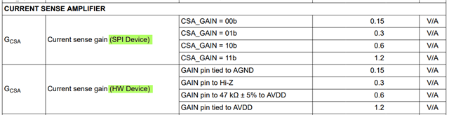

There aren't any differences between the variants of this device when it comes to the specs such as sleep mode current, peak current, and abs max voltage. When there are differences they would be noted in the datasheet like this:
and usually related to the features.
