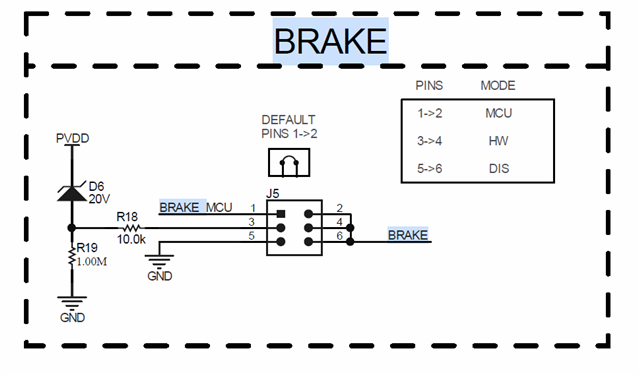

  • For the sleep status:
    Whether the bottom bridge driver is still turn on?
    another question is about the brake circuit:
    R19 is 1M. But the leakage current of D6 could be several uA, so the voltage could be several Volt, whether there are some risks?
    Thank you for your questions. Will feedback to you in 24hours.
    During sleep state, bottom side of driver is turned off. GL5-8 has semi-active pull down, then external low-side FET are turned off.
    GL-1-4 also has passive pull down. Therefore, external low side FET are turned off.
    BRAKE pin's abs max is PVDD. R19 can be reduced if needed. Then drawback is increasing leakage current from PVDD. R19 of 1Mohm is just example.
    Please generate new post when you ask new questions from next time. Thank you for understanding.
