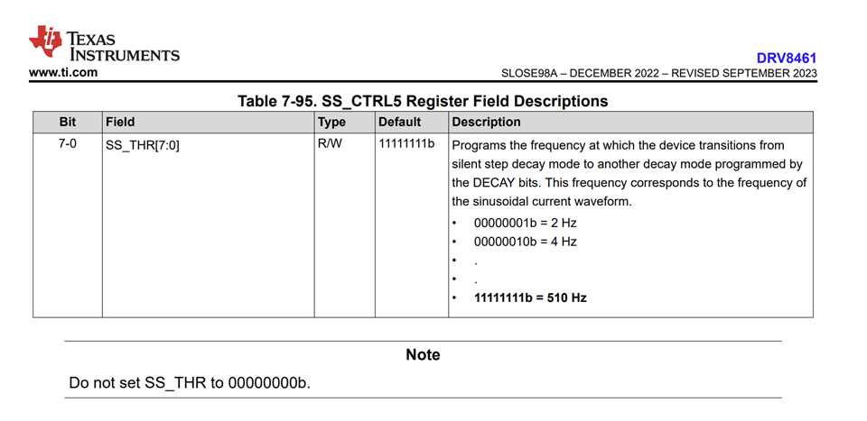

    The SS_THR can be set up to 510 Hz electrical frequency of the coil current.
    With this formula: fSTEP = (SS_THR * 1000 * usm) / 256 fSTEP is 10240 at highest speed and usm is 256, so SS_THR should be 10Hz?
    Like mentioned about if auto-microstepping sets usm = 256 from 1/8 μSteps mode it would still remain at 1/8 μSteps step rate for calculations purpose, so 320 Hz. You can have SS_THR set to 510 Hz so at 320 Hz, SS will remain enabled.

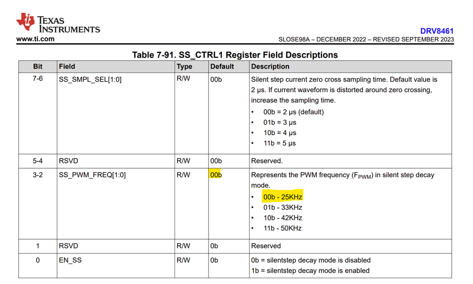

    KI = 0.44 * 1.8 / (25000 * 2.8E-3) = 0.0113, assuming default fPWM = 25 kHz was set.
    Following the lead of the below example from the datasheet you can calculate SS_KP, SS_KP_DIV_SEL and SS_KI, SS_KI_DIV_SEL. (SS_KP/SS_KP_DIV_SEL) = 0.44 and (SS_KI/SS_KI_DIV_SEL) = 0.0113. Find the ratio that offers the result accuracy as close as possible to the desired fraction. These would be a good starting point. After setting these values you could fine tune SS_KP and SS_KI with small increments or decrements to render the output sine current with minimum distortion and proper IFS amplitude. Note, because SS mode operates with fixed PWM tON and tOFF the current regulation is based on the closed loop SS parameters.

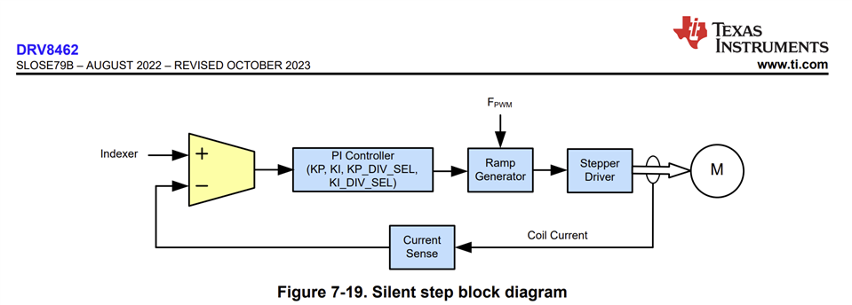

    On higher speeds (starting at around 3000 steps/s, ca. 100Hz) , as soon as I add load, the motor stalls. If I then increase the current, it works again but I need more current than without this mode and on the highest speed (10240 steps/s) I can't increase the current enough (tested until 3A).
    Is there anything I can do or do we have to live with the fact that more current is needed with this mode and we have to do without it at the highest speed?
    While in SS mode current regulation is done by the SS loop control and not by VREF based ITRIP comparators, although VREF must be present. See below control block diagram. This may be the reason you had to set a higher current. Did you look at the actual current waveforms to see if there is reduced torque in SS mode compared to 256 microstep mode? Thank you.
    Regards, Murugavel
