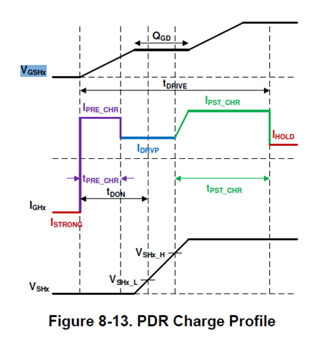

i saw the following picture in our datasheet. could you further explain what is difference between VGSH and VSH

VGSH is referring to the voltage on the GATE of FET minus the voltage on the SOURCE of FET. VSH is just referring to the SOURCE of FET. I recommend reading through this app note to understand the turn-on behavior of FET:
