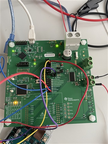

Hello everyone,
I would like to control my DVR8262EVM with an STM microcontroller, but there is no Output.
The output of the STM is 3.3 V. I have set the pins as follows:
nSleep: 1
IN1: PWM Signal
IN2: 1
Vref: 1 (3.3 V)
Mode 2: 0
Mode 1: 1
However, the output is always at 0.
Can anyone help me here?
With the GUI it works.
Many thanks in advance.

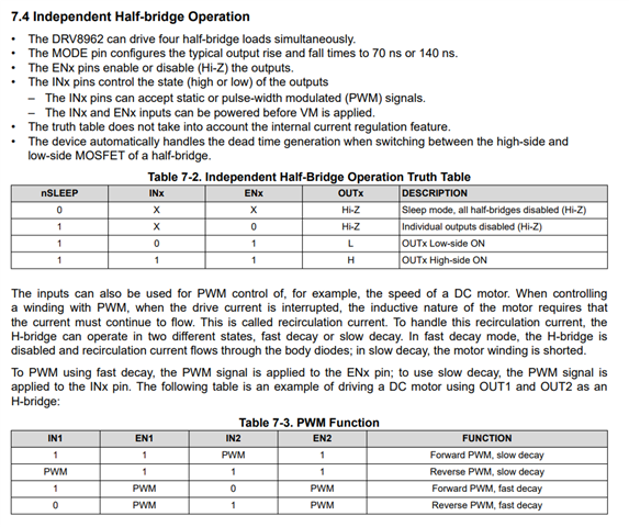

  • Hi Sabastian,
    Thank you for posting in this forum.
    The DRV8262EVM has ENx pin to enable and disable outputs. Please apply signal into ENx pins based on the following table.
    on the EVM boards, the ENx Pins can be found on J8.
    please let me know if you have any questions.
    Mojtaba.
  • Hello Mojtaba,
    Thank you very much for this Answer.  I followed your tipps as it's written in the table:
    nSleep: 1
    IN1:1
    IN2:0
    EN1: PWM
    EN2: PWM
    Mode 1: 1 (one motor)
    Mode 2: 1 (PWM interface)
    There is still no ouput.
    What am i doing wrong?
    Sebastian

  • Hi Sebastian,
    Thank you for the update.
    Please check the pics below that shows the EVM. To test the HW interface
    1- open J4 and j8 jumpers.
    2- Connect mode0 (yelow wire on j4)  and mode1 ( Green Wire on J4) to  3.3V.
    3- Connect IN1 (Blue wire on J8 ) to 3.3 V and IN2 (White wir on j8 ) to GND.
    4- Connect nSleep to 3.3 to enable the device (Black wire on j8).
    5- Check the output Voltage on OUT1 and OUT2.
    6- To set the current you need to provide VREF. First open J6 jumper and then apply voltage on the top pin of J5.( Orane wire)
    7- Connect VM to supply.
    8- Connect USB to PC if you are using 3.3 on the board.
    9- The output voltage will be VM volt and GND depending on the IN1 and IN2.
    10- To change the voltage and accordingly speed on BDC, you need to apply PWM to IN1 and IN2.
    Blue: OUT1, Yellow, nFault. IN1 = 1, IN2:0
    Please let me know if you have any questions.
    Mojtaba.
  • Hello Mojtaba,
    Thank you very much for your help!
    I have exactly the same configuration as yours, but there is no current:
    Maybe something is wrong with the board?
    Sebastian

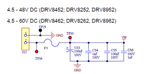

  • Hi Sebstian,
    Please check the fuse and see if it is fine or not.
    Moreover, you can check the usb input and see if Provide 5 V, and then check the U3 to see if it has supply and provide 3V3 or not.
    Mojtaba.
  • Hello Mojtaba,
    Thank you for your message.
    On TP36 and TP30 i have the input voltage from the supply.
    Then U3 has an input voltage on PIN 8, but there is no output voltage on PIN 1.
    Sebastian
  • Hi Sebastian,
    This may cause this issue. You can replace it with a new part to see if the board works.
    Please let me know if you have any question.
    Mojtaba.
