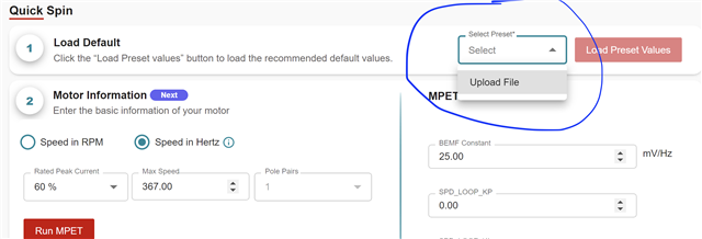

I'm using Motor Studio to program the MCF8329EVM to spin a BLDC motor. On page 5 of the Tuning guide, it states "Using the Select Preset drop down menu in the Load Default section select a register configuration which is most similar to the application use case or the Default MCF8329A Registers option." I do not have any of these options. Can you please send the default register configuration?

    Thanks for reaching out to us on e2e. The default preset and application specific configuration option is removed from the MotorStudio as of now. We are planning to update the QuickSpin page. Will update the application note soon accordingly, apologies for the inconsistency. Could you let me know the application you are targeting so that I can see if I have a closely matching configuration file myself which I can provide.
