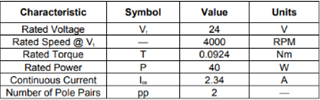

I have an AM263P LaunchPad kit, and I would like to control a BLDC motor using it.
I have successfully ported the AM263 Motor Control SDK to the AM263P platform and would like to continue using this SDK.
For the motor driver, I’m using the X-NUCLEO-IHM08M1 board.
The parameters of the BLDC motor I want to drive are shared in the attached image.
 Is it possible to drive this BLDC motor with the setup I described?
Are there any parameters I need to modify in the code to make it work with this specific motor?
If so, what are those parameters and how should I modify them?
Thank you in advance!

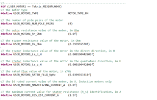

    Please check the TIDM-02018 design guide to tune the controller for your specific application. Regarding BLDC motor parameters, you need to define new motor and adjust their parameters in "src_board/user_mtr1.h" file.
