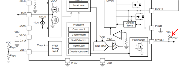

    I checked you schematic and need to consider following points:
    1- Use a 100 uF bulk cap on the VM pin.
    2- Why did you use the series resistor on the SDI, SCLK and SDO pins. Also the pins are internally pull down and you do not need to pull it down externally.
    3-nFaULT IS AN OUTPUT pin and is not be pulled up.
    For your reference, please use the design file for DRV8889EVM can be downloaded   DRV8889-Q1EVM Evaluation board | TI.com   under design file
    After revising the design, please check the nFAULT and nSLEEP signals under OL.
    Please let me know if you have any issue after revising the design.

  • I checked you schematic and need to consider following points:

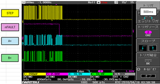

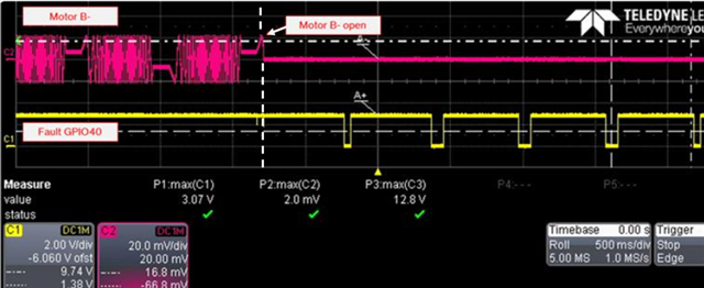

  • Thank you for your reply.
    Pink is Motor B current. Yellow is fault signal.
    If the Motor B is Open, the Motor current goes to zero.
    Still, I want to know why the fault signal is not Low and repeats High and Low.

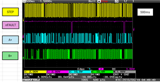

  • Hello team,
    I add the information.
    When both A and B are open, Fault goes to Low.
    when only B is open, Fault seems to repeat H and L.
    My customer would like to know the root cause or this issue.
  • HI,
    Based on this capture, it is not clear how the nFAULT is cleared. Would you please show the nSleep with the motor current and nFault as well. If you can please provide the FAULT Status register.
    Best regards.
    Motjaba
  • Hi
    Under OL fault the DRV8889 is working under its normal operation as it is shown below:
    Would you please clarify the reason that the STEP pulse is stopped when the nFAULT goes low?
    Under OL fault the output voltage still exist. Would you please check the nSLEEP, current and nFAULT while OL happened.
    Mojtaba.
    When the motor opens both A and B, the fault signal goes to Low.  ⇒ Expected behavior
    When only A is open, the fault signal goes to Low. ⇒ Expected behavior
    When only B is open, the fault signal repeatedly High and Low. ⇒ Not expected behavior
    The waveform result is attached. Could you please check it.
    DRV8889 Motor OL detection.xlsx

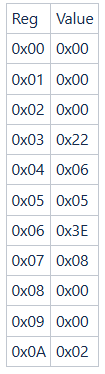

    Thank you for your feedback and new information
    Our register setting
    TRQ_DAC [3:0] : 87.5 %
    micro-step : 1/64

  • Hello Endo-san,
    Thanks for sharing the register contents. Based on these settings the microstep setting is 1/8. However this is not related to the OL issue. Per the schematic, VREF = 0.5034 V or 0.229 A for 100 % TRQ_DAC. Since you have TRQ_DAC = 87.5 % the actual IFS current setting would be 200 mA.
    Would it be possible to share the stepper motor datasheet? Specifically coil L and R values? Meanwhile, with the same register settings you had with 1/8 Step mode could you please repeat the OL test for B coil with IFS current set to 400 mA? If you perform this 400 mA for short period of time the motor will not overheat. But a quick check will be helpful to debug the issue. If nFAULT latches as expected you can try a lower current by -50 mA increments. Please also let us know the STEP input PPS used for OL testing. Thank you.

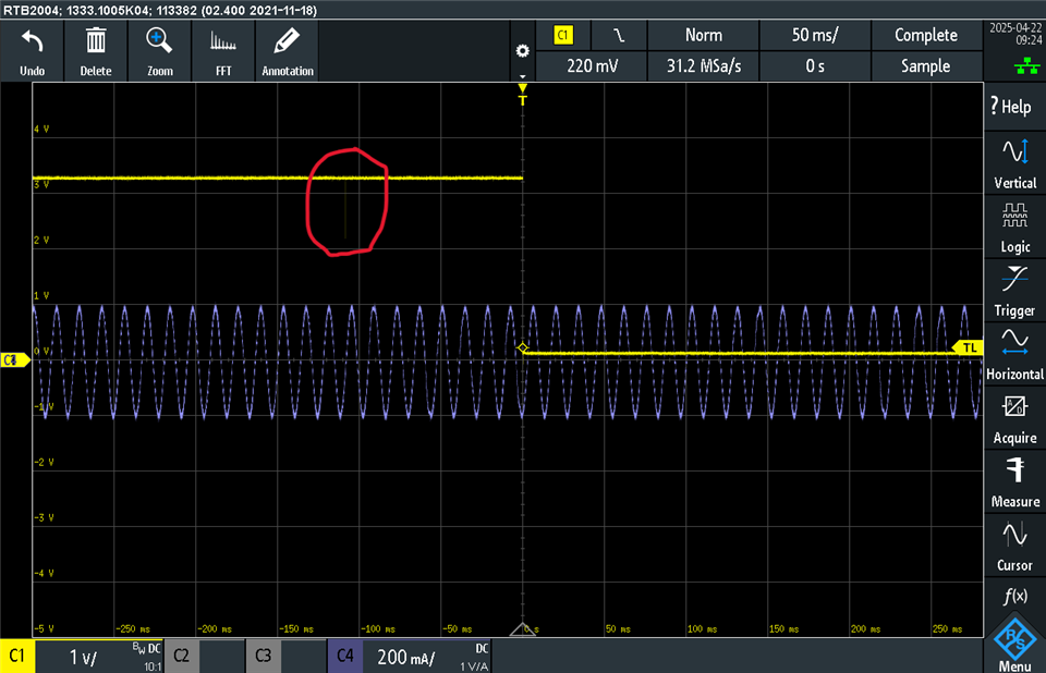

    Thank you. L you meant 11 mH. The PPS seems high at 1/8 Step, I assume 18432 PPS was for 1/64 Step. With 1/8 Step 2304 PPS would give the same stepper speed as 18432 PPS at 1/64 Step.
    While we do not have a stepper with the same specifications you mentioned we tested with an automotive headlight ADB stepper that had 10 Ω DCR and 12 mH L. The hardware used was a DRV8889-Q1, VM = 12 V, the IFS was set to 200 mA to match with your test setting. The SR was set at both MIN and MAX setting for the tests. The results did not change with SR settings.

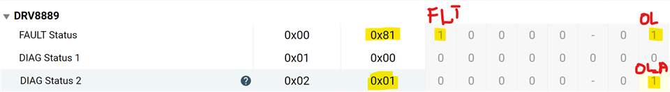

    1/8 Step, 2304 PPS coil A open:
    Note: I circled a spike on nFAULT which also happens on the GND and power rail because of the sudden disconnect of the motor coil while it was driven. From that spike about 160 ms later nFAULT goes low indicating an OL fault. The tOL specification for the DRV8889-Q1 is MAX 200 ms.
    See below diagnosis registers readout:

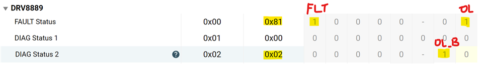

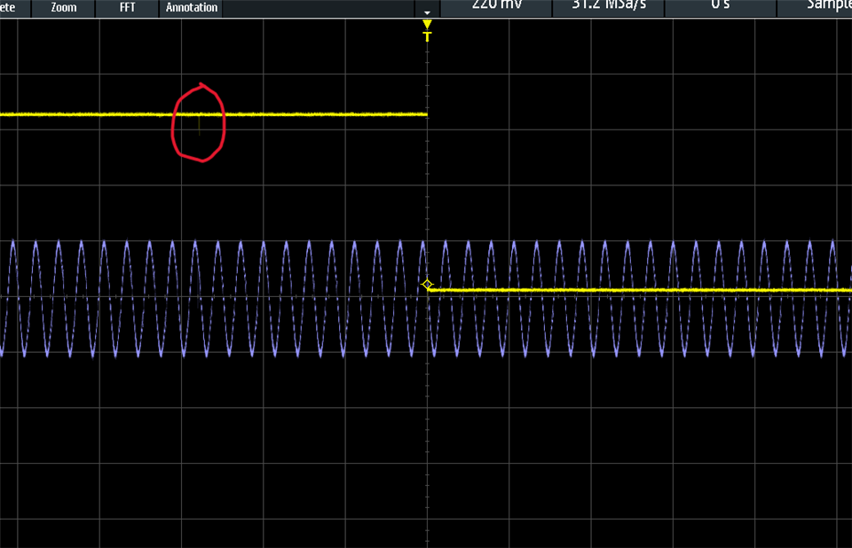

    1/8 Step, 2304 PPS coil B open:
    Note: Similar behavior as coil A open.
