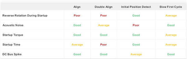

Question 1: Which startup method is better? Currently using IPD.
    Please find the reference for selecting startup method below, you could select the appropriate method based on your application:
