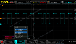

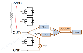

As shown in the figure, when OUT has an output and the relay is normally closed, short-circuit OUT to PVDD, and the relay opens. Then disconnect OUT from PVDD, and the relay remains open. However, the state detected by 3946 is normal (the relay is closed). This kind of malfunction is very serious. How can it be identified through 3946?
