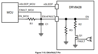

    1.
    If the voltage on the VM pin ever drops below the UVLO threshold for the power supply, all outputs are disabled, and the EN/nFAULT pin is pulled low. The EN pin is shared with the nFAULT pin and if fault reporting is being used, the following configuration should be used.
    "When a fault is detected, EN/nFAULT pin is forced low by turning on Q1 - which discharges the capacitor C1. The H-bridges are disabled when the voltage on the EN/nFAULT pin falls below the VIL threshold. The bridges stay disabled till the fault condition is removed or a second MCU pin directly applies a voltage higher than VIH to the EN/nFAULT pin. Thereafter, Q1 is turned off and C1 charges back through the resistor R1."
