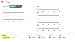

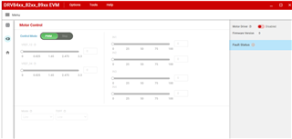

Does DRV8955 have the EN1-4 setting like DRV84xx? We cannot find it in GUI.

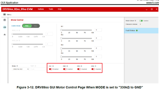

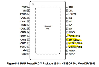

Hi Wayne,
Thank you for your question. The DRV8955 Enable pins are active when a 330k resistor is connected from MODE pin to ground. Please change the mode to 330kOhm to GND.
Please let me know if you have any more questions.
