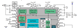

  • Hi Adriana,
    The health of AVDD ensures the internal LDO on VM is functional. And DVDD voltage is critical as it powers the whole digital circuit of the IC. Typically DVDD is extracted from the FB_BK (buck converter output). How is your design implementation? Could you share the schematics for me to review?

  • Hello Sachin,
    I'm sharing part of the schematic for you to review and let me know if you notice anything unusual. The issue only occurs when I try to communicate with the MCF8316C-Q1, regardless of whether it is pre-programmed or not.
    The circuit is implemented on a client's board, and they made a mistake when writing the parameters. As a result, I need to overwrite the information, which is why I require communication with the circuit.
    I appreciate your feedback.
  • Hi Adriana,
    I think the design looks okay. Could you share your I2C implementation.
