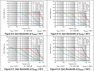

What would be the maximum capacitive load, which DRV2700 can drive?

Hi Kuwahara-san,
This will depend on the frequency being driven and the desired peak to peak output voltage. You can refer to the below plots from the datasheet to see DRV2700's capabilities in driving various capacitive loads.
