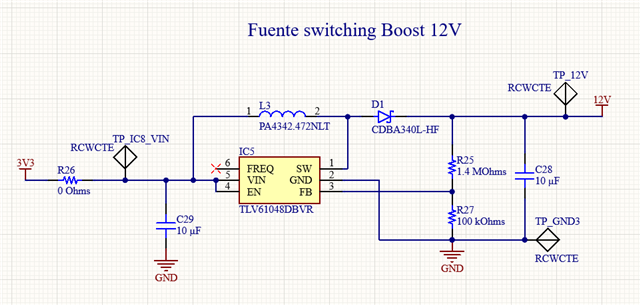

Regarding the changes, what I did is change the 12 VDC power supply. I chose the TLV61048DBVR from TI, which has a peak switching current limit in between 2.9 and 4.5 A:

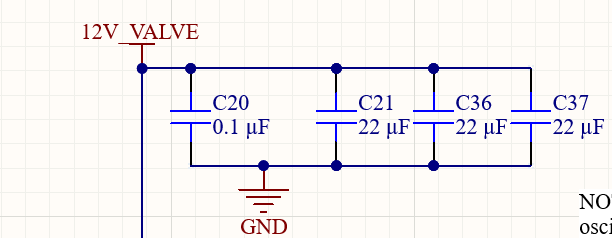

In addition, as Jacob suggested, I added a series of capacitors to each output, for a total value of 66 uF:

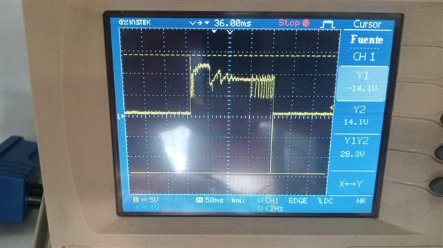

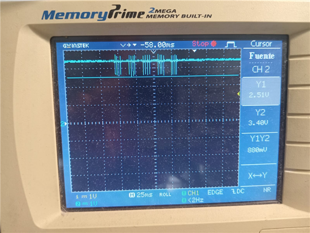

Now, regarding the results, sadly, they remain the same. The ESP32 still resets. I was able to see the voltage drop in the 3V3 line when the valve is triggered:
As you can see, the voltage drops below 1V.

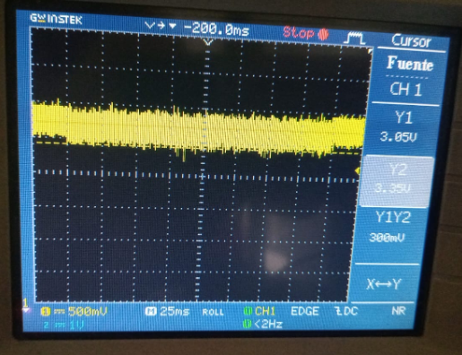

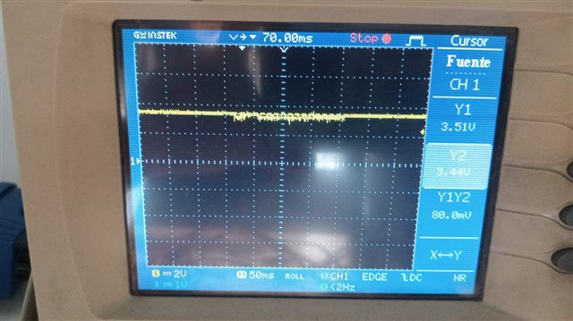

Then, what I did Is try to isolate each power supply, so I could find which one is failing. First, I powered the board with 4V between the output of the battery charger and the input of the 3V3 power supply, and tried to trigger the valve. And with that test, the valve was able to open without causing the ESP32 to reset. This is what I saw in the 3V3 line:
As you can see, although there's a voltage drop of around 500 mV, it doesn't drop below 1V as before.
What I get from this test is that the problem should be in the battery charger IC, which is the BQ25892 from TI. But the things is that that IC, at least according to its datasheet, can support of to 5A of switching current, a value well above the one that the valve requires to switch. I know that that IC has some current and voltage configurations, such as the maximum allowed switching current, but I've checked those values, and the ILIM current is set to 3.25 A, and the VREG voltage is set to 4.208 V, so I would say that that's not the problem.

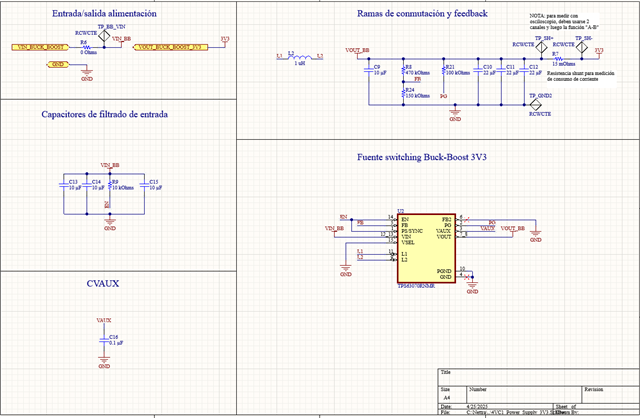

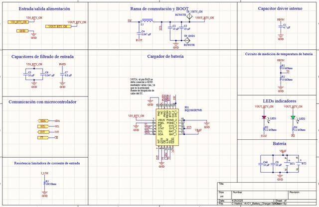

  • Franco,
    Can you post your full schematic?
    Are you using the BQ2589x as an LDO or buck converter to generate the 3.3V logic voltage? Seems like that would be better served by an LDO or a buck converter, the BQ25892 is a battery charger so it might be tripping or throwing warnings if it senses its load is not a battery.
  • Greetings Jacob.
    Thank you for your help. Regarding the SCH, due to company policies, I can only share the parts of the SCH that are related to this issue, not all the board. So, here are the SCH of the battery charger, 3V3 power supply, 12V power supply and valve controller circuit:
    -Battery charger BQ25892:
    -3V3 power supply:
    -12 V power supply:
    -Valve controller:
    I apologize because there are some parts that are in spanish (I'm from Argentina).
    Regarding your 2nd question, I'm using the BQ25892 as a switching power supply and to charge the battery, so it generates 4.2 V which then powers the 3V3 Buck-Boost power supply, which then powers the 12 V Boost power supply. From what I understood, the BQ25892 can be used to power a load different from a battery, or maybe I'm mistaken. Or could be that there's some internal register to configure this case?

    David has looped us in to this thread. Your schematic looks fine. If I understand correctly the VIN_BB Net is likely connected to the VOUT_BTY_CH Net on the BQ device schematic. This would be a fine implementation.
    The BQ is able to source the required, the ISYS output current has a 5A current limit which should be able to provide current as needed. As you said the issue may lay in the transient response since it looks like the current load is applied very quickly. In this case the voltage drop may be due to the delay in loop response as current is quickly pulled out of the SYS capacitor. In these scenarios, it's typically recommended to increase SYS capacitance, VIN capacitance, or VBAT capacitance to provide a larger reserve to pull current from, without reducing voltage. Can you provide a waveform of the load pulses including VIN, SYS, and BAT?

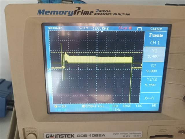

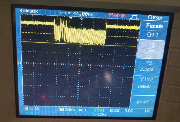

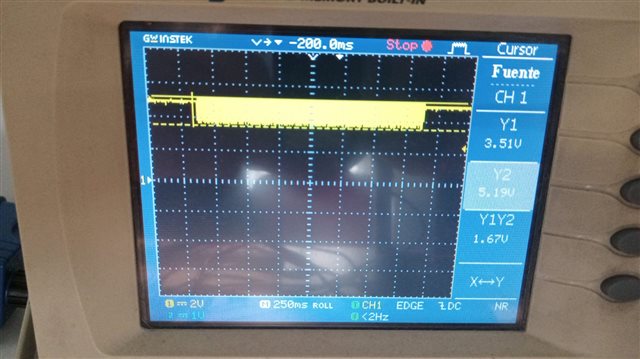

    Regarding the signals, I've aquired some pictures of them. And yes, the problem arises when I use the BQ alone, with no battery connected. So, I will split the signals into those where there's no battery and those where I put the battery:
    NO BATTERY:
    -LOAD:
    -VSYS (which is basically VOUT_BTY_CH):
    -VIN:
    WITH BATTERY:
    -VBAT:
    -LOAD:
    -VOUT_BTY_CH (basically VSYS):
    So, as you can see, the signals are quite normal when the battery is connected. According to what you said, this could be because the battery is acting as a capacitor in the transients, providing the needed current to switch the valves.
    However, I think that it would be great if the circuit worked even without the battery connected. So, for that case, what do you suggest? To add more capacitance in which places? And what values do you suggest?

  • Hi Franco,
    I didn't realize the issue was present while the Battery was not connected. If battery is not connected the output voltage of the charger is limited by the input current of the VBUS source, which as you mentioned is set to a maximum of 3.25A. This might be enough depending on the input voltage, higher input voltages allow the output to reach higher currents even given a 3.25A input current limitation. The input current limit might be reduced by protection measures such as VINDPM. Do you have a capture of VBUS in a no-battery setup when the load is applied?

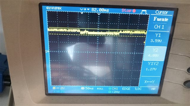

    Oh, I see, I didn't know that if you supplied more input voltage, the current limit incremented. In my case, I'm powering the circuit using a lab power supply, set to 5V. And I would say that yes, the current consumed by the valve should be way lower than 3.25 A.
    Regarding the VBUS signal, yes, it's on my previous comment, the image in the "NO BATTERY" section named "VIN". Just in case, here it is:
    Franco.
  • Hi Franco,
    Sorry I must have missed that. It looks like the load seems to be too much for your input source based on the voltage dips. The voltage of VIN seems to be dropping to levels in which it would trigger VINDPM or sleep, the device wouldn't be able to pull more current from the input once VIN has dropped a significant amount. If your input source should be able up to 3.25A of output current then it might transient response limitations on the part of your input source This can be mitigated by increasing the VBUS capacitor. If your lab power supply has a current limitation below 3.25A, you can try increasing this setting, or using a more powerful input source if it is maxed out. This should confirm that is the cause of the behavior we're seeing.

    Sorry, I'm posting again because I've made some test, and seem to have found the final solution. Sadly, I can't mark this reply as "This resolved my issue", but well, hope it helps anyway.

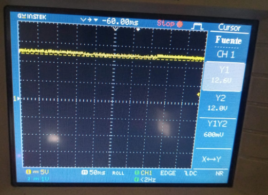

    First, I bought a 2200 and a 4700 uF capacitor (35 V both). Then, I soldered them in different places of the power line of my board, and testes the results when switching the valve. I was hoping that, with such a huge capacitor of 4700 uF set in the 12 V line, the problem would be fixed, because it could provide the current needed by the valve in the transient. But, although in some cases the ESP32 didn't reset, the truth is that, watching for example the 3V3 line, I was still seeing a considerable voltage drop, of about 1 V. Here's an example:
    In this case, the battery was connected, and I was powering the board with my lab power supply, with 5V.
    Then, I thought: "well, maybe the real solution would be to mitigate the peak current in the valve, which is the real cause of this problem". So I thought I could add a resistor in series with the valve. I first tried with a 100 Ohm resistor, but with that value, the valve couldn't even get enough current to switch correctly. So then I tried different resistance values, with the help of a potentiometer, and, for example, with a value of 25 Ohm, the valve seemed to switch correctly, and the voltage drop nearly dissapeared. Here you can see the 3V3 line:
    And here the 12 V line:
    So, in conclusion, I think I will just add a series resistor to each valve. I'm still curious about why the huge capacitor didn't work as intended though.
