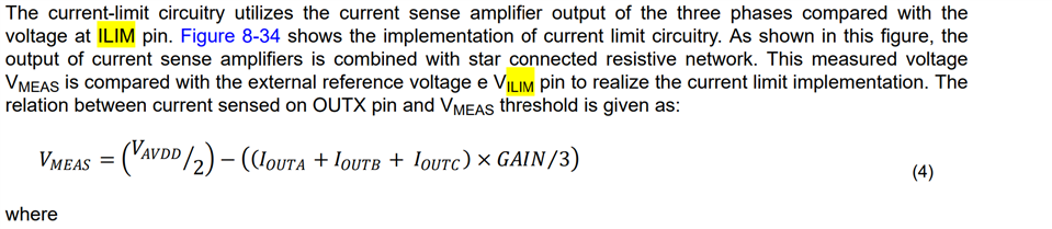

Hello Dear All,
I want to set up my ILIM limit to 3A, for this value how can I calculate my ILIM resistors? Is there any formula or resistor value?
I checked evm manual and datasheet but I did not see.

You can use below formula
Input IOUTA+IOUTB+IOUTC to 3A and find the VMEAS required to achieve this.
Thanks and Best Regards
Venkatadri S
I confused about that formula, could you please calculate for me as 3A?
Hi Oben,
VAVDD is 3.3V, and you can take the sum of currents as 3A. So that gives us VMEAS = 1.75V - (3xGAIN/3).
So set the voltage on ILIM pin equal to VMEAS = (1.75 - GAIN), here GAIN is in V/A which you will set. For e.g if you are using the HW variant, the GAIN is constant at 0.15V/A which gives us VMEAS = (1.75 - 0.15) = 1.6V. So if you set 1.6V on ILIM pin, you will get a 3A limit.

Hi Oben,
For ILIMIT to 3A VLIM (VMEAS) should be set for 1.5V
CSA_GAIN should be 0.15V/A and in hardware configuration it is always 0.15V/A.
AVDD = 3.3V
Now calculate IOUT by re arranging the equation which will be 3A.
