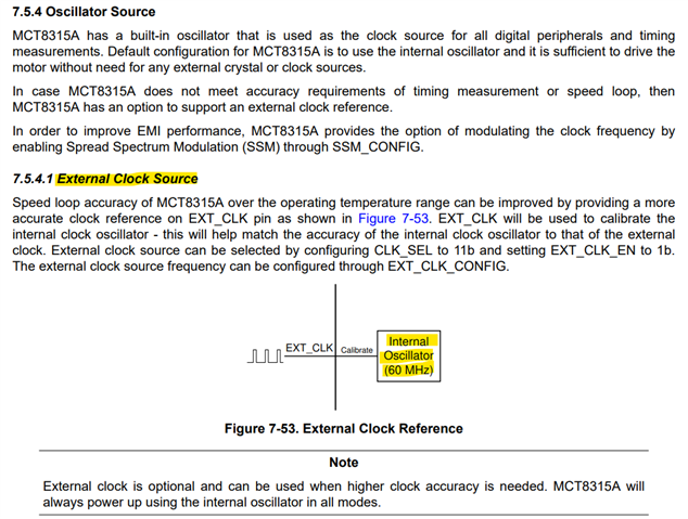

Dear Team,
My customer is evaluating the MCT8315A in their system.
They are considering using an external clock source to improve speed loop accuracy.
Q1: Is there a specification for the On duty width of the external clock source?
Q2: What is the accuracy of the internal clock (60MHz)?
