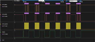

    Also can you provide a waveform of the SPI transactions after the inital power up(including SCLK, nSCS, SDO and SDI)
    Ibinu
  • Hello Ibinu, Below are schematics for both drivers :
    Also I am providing the below initialization waveform for init state and broadcast
    We were expecting the output 2 should be high and when we send closure command the output should get transition from high to low, but the status of output2 is low as can be seen in below graph and when we request for closure, driver get enabled as per EN1 transit to high but no change in output 2 and when we send open command the is spike for few microseconds and driver will get disable.
  • Hi Devandra,
    Thank you for the captures. I will review them and get back to you tomorrow.

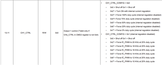

    Below are configuration Register values (XX are CRC value calculated at run time and no CRC warning present). Both driver have same configuration.

  • Hello Keerthi,
    We have set CHX_CTRL_COFIG as 0 and when we are setting 0x2 (Internal current regulation) value when closing contactor.
    First issue seems to be resolved due to HW bug and mostly probably 2nd issue might be resolved once we get actual contactor with latest HW.
