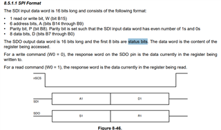

Hi team,
What is the status bits means? I don't find much explanation on this.

Hi Fanbin,
This is IC status register (IC_Status_Register Register (Offset = 0h) [Reset = 00h] )
