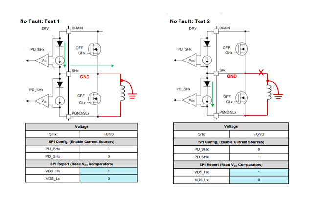

The offline diagnosis of the H-bridge (motor control) only requires one configuration, but the offline diagnosis of the half-bridge (heating control) needs two configurations

Thank you for your questions.
Yes, it is correct.
