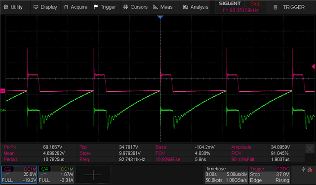

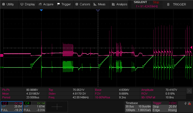

    I have captured some waveforms at the SW node, as well as the voltage across a 0.12 Ohm shunt that is in between the SW node and the primary winding.
    The first screenshot shows the behaviour straight from startup. The second screenshot is after a few seconds of operation. I notice also that my SW node peaks at around 117 V. This is evidently being caught by the Schottky + Zener snubber I used, however this is beyond the maximum ratings of the FET. I will try a lower voltage Zener, in case I am damaging the primary FET and affecting the operation of the device.

    The above 2 screenshots in my last reply were actually captured using a newly wound flyback transformer. I was concerned that primary to secondary capacitance was too high, so I wound another with the primary separate on one side of the bobbin, and the secondaries on the other side. This however greatly increased the leakage inductance, which I believed caused excessive heating in the diode snubber network. I've now returned to a stacked winding approach, with the primary closest to the core and secondaries on top. I have 12 turns of primary and 4 x 72 turns of secondary. I now get the following waveforms, but still experience feedback voltage sag if I try and push the output voltage too far:
    Startup:
    Continuous run with voltage limiting:
    I managed to get the design working up to 2 kV this afternoon. I replaced the S8CMHQ output diodes with the part used in DRV2700EVM-HV500 (4 of MMBD3004S-7-F in series per output winding). I am not entirely sure why this worked, but I do have a theory:
    S8CMHQ has around 70 pF of capacitance, whereas the series string of MMBD3004S-7-Fs I replaced it with should be under 1 pF per winding. I think it is possible that the 70 pF of diode capacitance was ringing in combination with the leakage inductance on the secondary side of my flyback transformer. Looking trough the datasheets for the two parts, I can't really see any other major differences.
