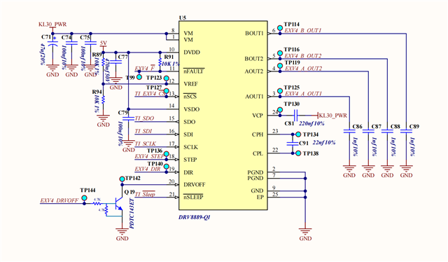

2. The following is customer's schematic, could you help review and give some comments?

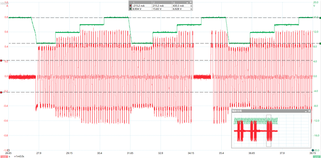

3. In testing, the customer found that when the DRV8889-Q1 is configured as 1/2 step, the output phase current varies significantly between VMs, as shown in the following figure. However, when the DRV8889-Q1 is configured as 1/16 step, the output phase current value is basically the same for different VMs.  May I ask that why is that? Theoretically, the output phase current should be independent of VM.
    The schematic looks okay. VREF = 2.5 V or 1.14 A IFS, I full-scale assuming TRQ_DAC = 100 %. I think TRQ_DAC was set < 100 % to get IFS = 600 mA, correct? What is the specified coil current for the stepper?
    Yes theoretically this hold good as long as VM - VBEMF > IFS x DCR. So in customer's waveform VM = 14 V and 16 V current waveform looks constant amplitude suggesting 8 V and 12 V was not sufficient to achieve the target current because VBEMF was not allowing it. Solution could be to reduce PPS step rate and/or reduce target current and/or increase minimum VM to 14 V and above.

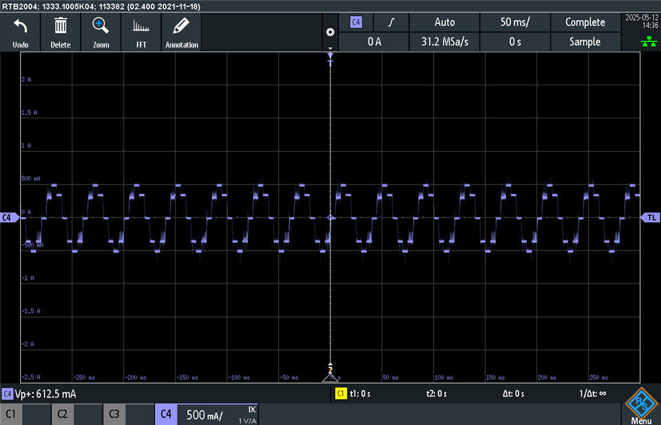

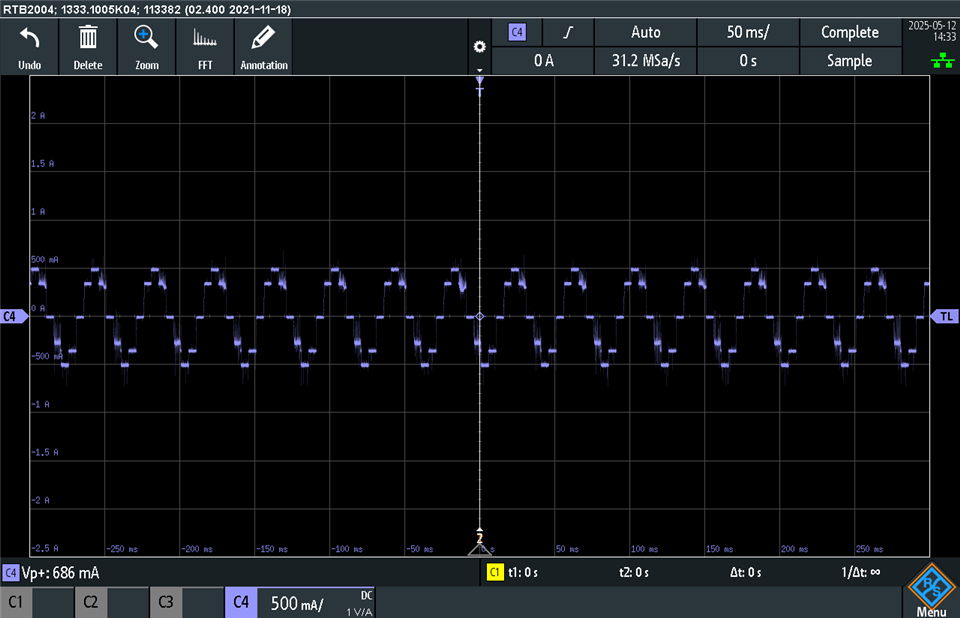

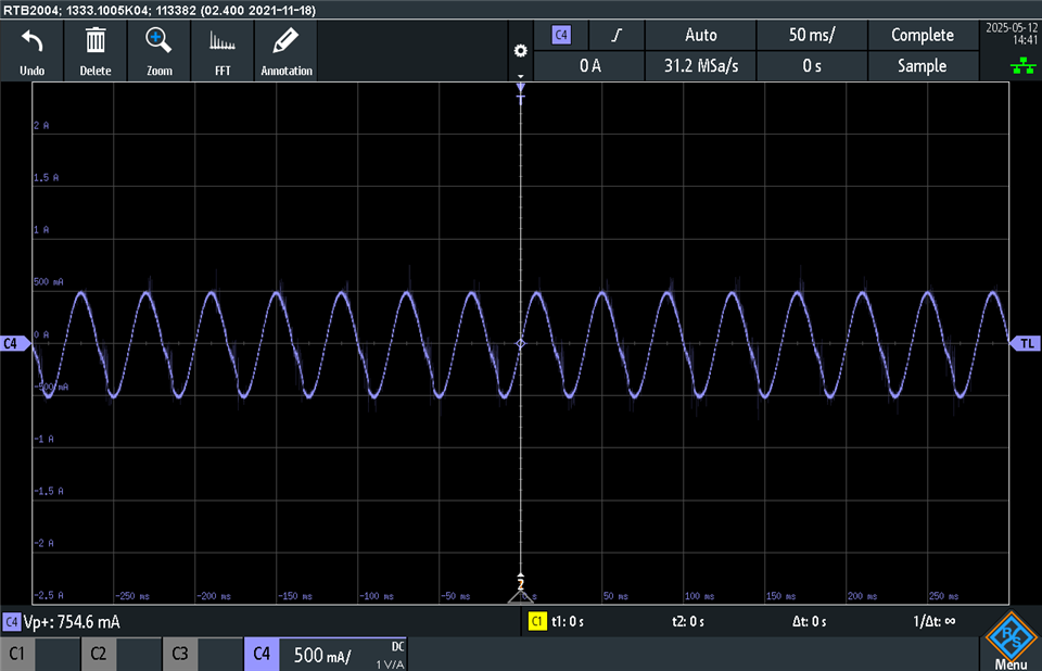

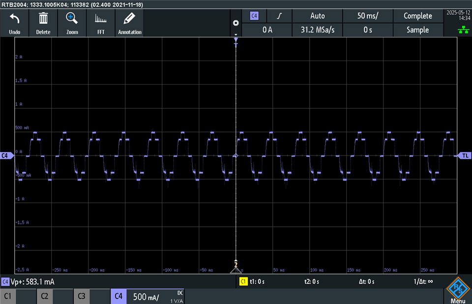

    See below example, 1/2 Step 500 mA IFS 200 PPS. I assume Smart Tune Ripple Control decay mode was used in customer tests.
    With VM = 9 V:
    With VM = 12 V:
    With VM = 16 V:
    With VM = 12 V, IFS = 500 mA, 1/16 Step, 1600 PPS:
    If the PPS is too high and VM = 9 V the target current may not be reached and could result with step loss. The driver works as intended. Thank you.

    I still have a question, when EXV valve (stepper motor) starts, the envelop curve of phase current fluctuates for the 1st drive of target steps. This phenomenon only happens when the vehicle is powered on, and obvious for the 1st drive control of target speed which starts immediately after vehicle is powered on.
    I mentioned previously the current through the winding would be (VM - VBEMF) / DCR Ω. So when VM - VBEMF < IFS x DCR the current cannot reach the target IFS. The VBEMF of a stepper motor is a sine wave. So VM - VBEMF will be a sine wave, so the current is superimposed with this sine pattern from the VBEMF of the motor. VM is stable as shown by the battery voltage trace.
    Regards, Murugavel
  • Thanks for your reply. I think if the fluctuation of amplitude of phase current can't be avoid, we should make sure the minimum of  phase current should be larger than the specified value.
    The graph above shows using 1/16 STEP mode, we configured the TRQ_DAC as 18.75% which regulates the current as 220mA. Basically, we were going to  raise the TRQ_DAC in the hope to get a larger regulated current, but from your reply, this will not have a good effect. It seems that the best way is to reduce the rotation speed. We will test in bench and on the vehicle to have a check of the result.

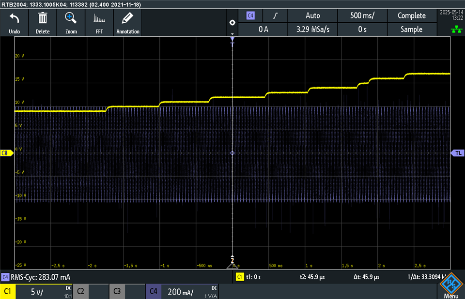

    You mentioned specified speed as 100 pps. I assume this would be with full-step and with 1/16 it would be 1600 pps, is this correct? I have a generic EEV with 20 Ω coil in our lab. I tested this valve with a DRV8889-Q1EVM. IFS set at 400 mA peak (283 mA RMS), 1/16 Steps, 1600 pps.
    With voltage stepped from 9 V to 17 V, yellow is VM and blue is current:
    Yes this will help maintain minimum torque output. Thank you.

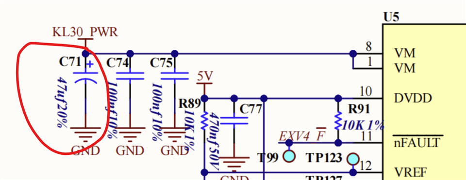

    The phase current amplitude fluctuated EXV is named as BEXV, We have checked that if we remove some EXVs, fluctuation of current amplitude of BEXV did not occur. We have no clear idea of the reason. But according to the words mentioned previously "theoretically this hold good as long as VM - VBEMF > IFS x DCR", on occasion of VBEMF reach the max value when motor rotates, regulation of phase current may not hold good and will cause fluctuation. I assume this may be the reason but occurrence condition is not easy to identify.
    This would be the highly likely reason. Increasing C71 to > 100 uF placed close to VM of each driver may help mitigate this issue. Thank you.
    We will refer to your advice for future design. As all hardware related tests of this project are already finished, and all reports are received, it's hard to make any hardware changes. We will raise the drive current to make sure no lose of steps in driving cycle.
