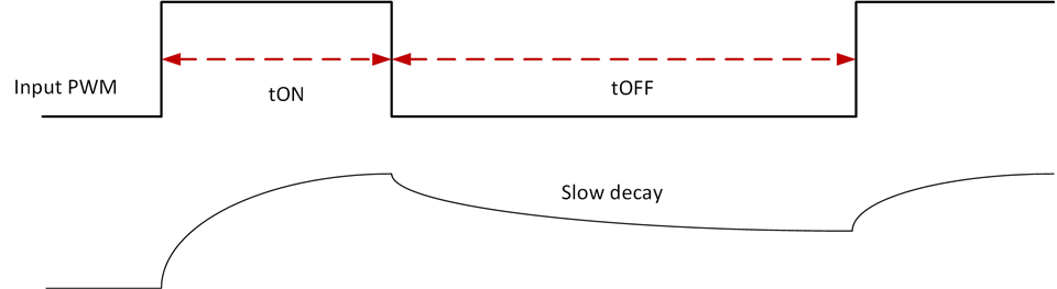

    Now, looking at the DRV8703-Q1 Full-Bridge driver (note this does not apply to the DRV8703D-Q1 because this is an Half-Bridge driver), as indicated by "2" current flow while both low-side FETs are conducting it effectively behaves like shorting the motor coil, meaning the BEMF current would flow via the two low-side FETs causing the motor to brake. This applies to when the motor is not actively driven.
    During a PWM drive during the PWM on of the duty cycle the current "1" increases via the motor coil according to its supply voltage, R and L. During the off duration of the PWM both low-side FETs are switched on to allow the recirculation current to decay, aka slow decay. See below image for visualization.
