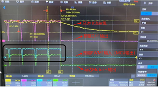

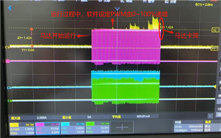

When they try to increased the duty cycle from 0% to 100% w/ duty step 10/1024 every 10ms, and they found that when the duty cycle is close to 100, maybe 90+%, the motor stopped. Which is very weird.
Below is the waveform: CH1: current, CH2: GH1, CH3: IN1, CH4: O_MOTOR_OUT+. You can check below schematic for the net position.

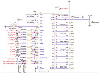

Below is the schematic:
Support need:
1. Help review the schematic to see if any risk lead to this issue
2. help analyze why this would happen. Thanks!

    Could you provide your customer's name and application use case. I will feedback to you for schematic review. Please create internal post if needed.

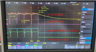

    I could see CH3:IN1 signal stopped then motor driving is also stopped. This could be normal. Looks like MCU provide PWM signal to DRV8714-Q1's IN1 pin. If PWM singal at IN1 stopped, DRV could not spin motor with PWM anymore.

    Is it possible that some kind of fault was triggered at that moment, I am asking customer to check if the fault register bit was set.

    MCU just stopped providing PWM signal to DRV. So may not have any fault condition.
