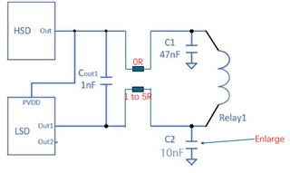

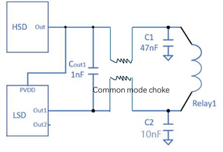

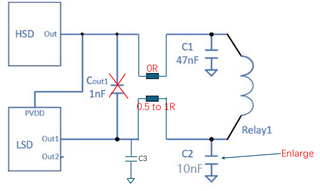

DRV3946-Q1: CE3 failed with output of DRV3946 cable at the frequency of 10M
Part Number: DRV3946-Q1
Hi Keerth
Yes, we already have output capacitors on the output(10nF for LSD output), we also increase the capacitor to bigger, but make no sense.
For the power supply(VBB) of 3946, we have 2.2uF+220nF+100nF in parallel.
Have you some other suggestion of the HW circuit?
