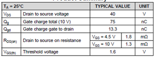

         Thanks.But what the customer wants to know is the parameters( Vds, Rdson, Qg, etc.) required by the external MOSFET to determine what MOSFET to choose.

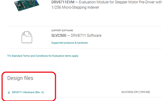

    CSD18531Q5A can be used as example. This FET is on DRFV8711 EVM
    www.ti.com/.../DRV8711EVM
    EVM schematic is here.
    CDS18512Q5B is another example.

        I know these EVM board and know use CSD18531Q5A and CDS18512Q5B.But my customer want to know how to choose the external Mosfet? For example,if the voltage of motor is 48V,current is 1A, What parameters of MOSFET should be selected? Does Vds require 60V or 80V? Or higher? How much does Rdson/Id require? Are there any requirements for parameters such as Qg and Ciss,Coss,Crss?
  • Hi Jon,
    Have you reviewed the datasheet section 8 Application and Implementation which provides application design details and specifically section 8.2.2.3 Support External FETs?
    The absolute maximum ratings for Power supply voltage VM for the DRV8711 is 60 V MAX. So MOSFET ≥ 60 V should be fine.
    This would depend on the power dissipation due to I2Rdson and switching losses, TA ambient operating temperature requirements of the application design. Usually power MOSFETs are very low Rdson sub 10 mΩ may be even sub 5 mΩ and can support several amps of motor current.
    Like mentioned previously, the DRV8711 can accommodate a wide range of these parameters because of programmable nature of IDRIVEP, N and TDRIVEP, N. Calculations are provided in the application section of the datasheet. Thank you.
