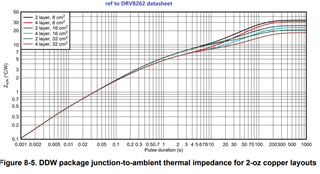

    In addition, I would like to know if you can provide a curve of JA thermal resistance of DRV8263 over continue time(0.1s, 0.2s, 0.3s 0.4s ....1s, 2s,4s...DC). I need to calculate the motor driving current capability in a short time and long time in our application based on this graph.
    It means to provide a graph like "Figure 8-5" in the DRV8262-Q1 datasheet. I want this graph of PDRV8263S.

    Sorry, we are currently using DRV8262 as single-channel. in the datasheet, RDS_on(HS+LS)=50mohm, while PDRV8263 is 85mohm. In addition, due to the small package of PDRV8263, its short-time JA thermal resistance is much higher than that of 8262. In this way, the current driving capability of DRV8263 is worse than that of DRV8262 single channel (by calculating the junction temperature, the maximum value of TJ is 150℃, considering the ambient temperature of 85℃).
    Am I right?
    BR
  • Hi Xiaoshan,
    You are correct. In single channel two H-Bridges in parallel mode the DRV8262 would be lower Rdson. You are correct about the higher RθJA for the DRV8263 package as well. Sorry for overlooking these. The DRV8263 does provide more diagnostics.

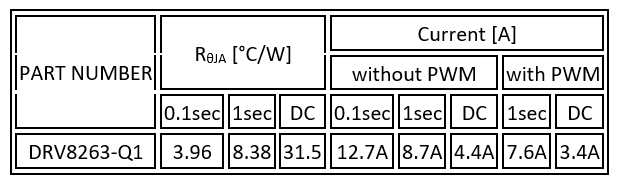

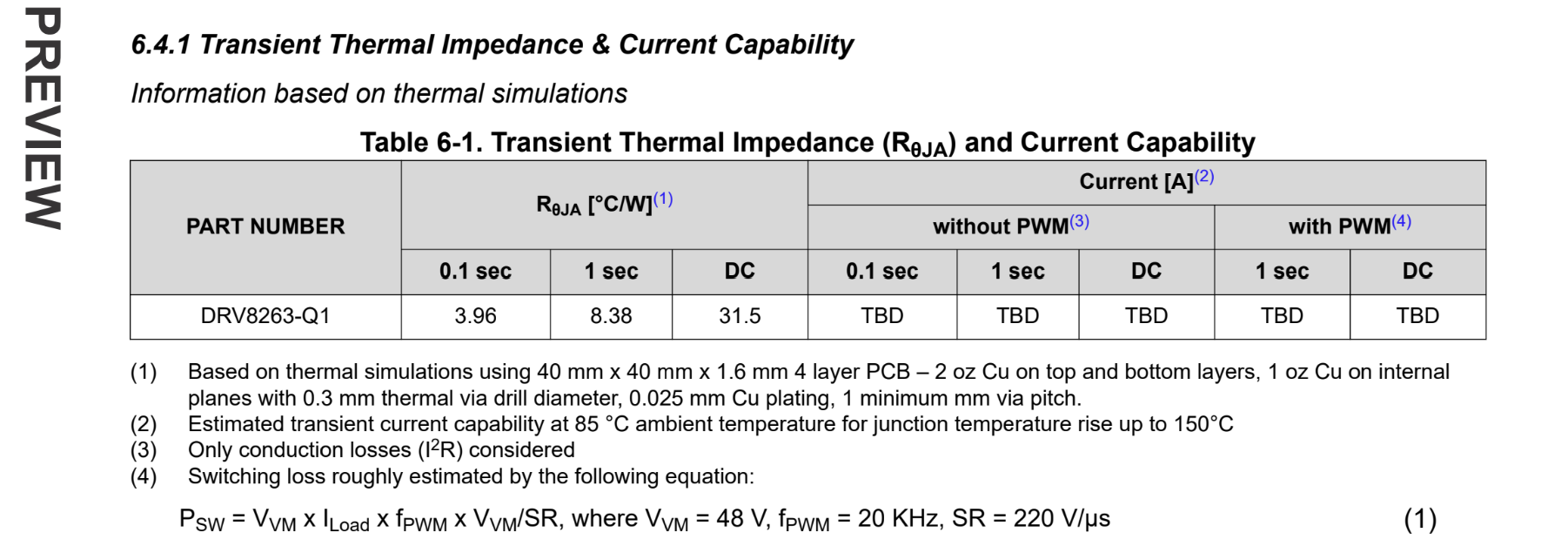

    The thermal graph for the DRV8263-Q1 is in works now. We will post it as soon as it is ready. Meanwhile I'm sharing the transient thermal impedance and current data - see below. Thank you.
    Regards, Murugavel
