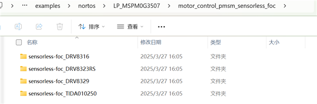

Hi Zbyno,
The DRV driver examples we achieved for MSPM0G3507 in SDK could be found below. Currently the DRV8376 driver example is not included in our SDK, but you could refer these examples for DRV driving and FOC achievement.
Pengfei

Hi Zbyno,
The FOC example based on DRV8376 is not planned to develop.
If you do need this example for your project, could you please contact the TI sales team and provide your requirement and project business information, so that we could evaluate internally to see how to support your case.
Pengfei

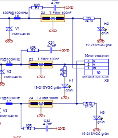

Hi Joseph,
I would like to know more about all members of the DRV83xx family (drivers with internal power MOSFETs). I have still only tested it with my design with DRV8316, and it was a separation of the power outputs from the IC (OutA, etc) to the motor inputs (U, V, W ) with the power inductor
like 2743021446 from Fair-Rite.
regards
zbyno

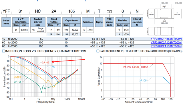

Thanks Joseph,
I knew these ICs. My question was: if this coil (ferrit) on the output pin could make the EMC better, and
If it will be necessary to add the Schottky diode (the anode on the ground) between the IC's output and the ferrite.
regards
zbyno
Hi Zbyno,
I understand your question,
I have used ferrites on output on some of our EVM's before with no issues. This is somewhat system dependent however.
It may improve EMC but testing would need to be done with your application to confirm.
I don't think the Schottky would be necessary.
My question is, have you seen concerning amounts of EMI in your testing of DRV8316 that is prompting you to use these Ferrites on outputs? I don't see how these would be necessary in the majority of applications.
Joseph
Thanks Joseph,
I'll measure and see. I am waiting for better results above 3 MHz.

Hi Joseph,
I want to test when it'll be necessary to use the output filter like I have used in my project:
https://www.researchgate.net/publication/342522062_Board_MP6540H_for_Nucleo64_G431a
regards
zbyno
