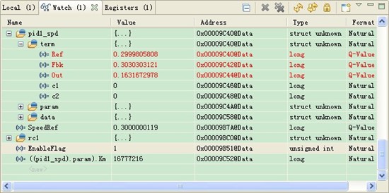

    for the question three,I know I was wrong,but show you a picture in CCS:
     I set the speed is Ref=0.3 when the motor is running stably ,the Fbk is also nearly 0.3,but why pid.out is not zero?I know it must not be zero ,it controls pwm.But just for pid block, when the system is stably.pid.out should be zero! Am I right?

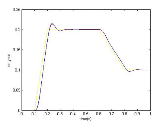

    Here is my simulation in Matlab:
     system in and system out,this is not important
    Here is the problem :when the system is stably,pid out is nearly zero
    where is my error?I misunderstand~~~

  • When Feedback = Reference that does not mean that PI output = 0
    If the output = you will get 0 PWM duty cycle.
    The output of the PI controller is the value needed to KEEP the Error (Ref-feedback) = 0
    Set your reference = 0, and after steady state when fdbck = 0 check the PI output.

  • HI,
       Thanks for explain so careful, I understand now: the output of PI controller is the value needed to keep the error equal zero.And I found out the error in my simulation by Matlab.
