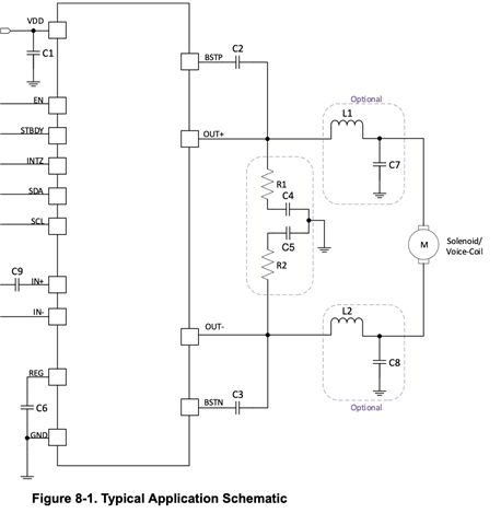

I had two questions:
1) We are using the DRV2510 and have an LC filter at the output.
When we enable the DRV2510 we immediately get an over-current fault, even with no load at the output of the filter network.
With reference to the diagram below, our value of L1 is 10uH and our value of C7 is 100uF.
Can you please explain why we are getting an over-current fault?
2) Is there a way to disable the over-current and dc offset faults?
