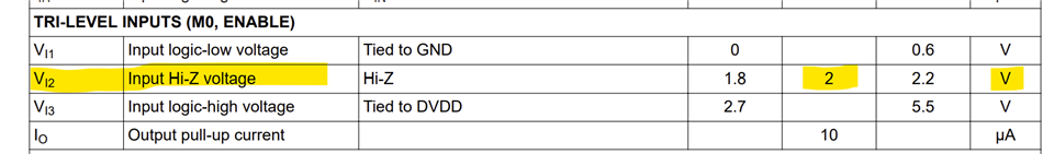

    I assume you left the ENABLE pin floating. To ensure it is in HiZ the voltage on this pin must be 2 V +/- 0.2 V. See specifications below. This is implemented in the EVM and works as expected. We expect the motor to step normally when this pin is HiZ for x8 torque count mode.

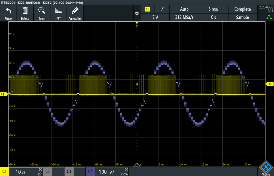

    Measured again on motor connectors on DRV8434AEVM board, and I get 50ohm over both connectors when morot is attached, and some 100Mohm when unattached.
    I then measured voltage over one coil just after nSLEEP has been deactivated above. Alternating current is 218mA, which should be well above open load current threshold.
    Is this a normal waveform when motor is in a static condition (not stepping)?

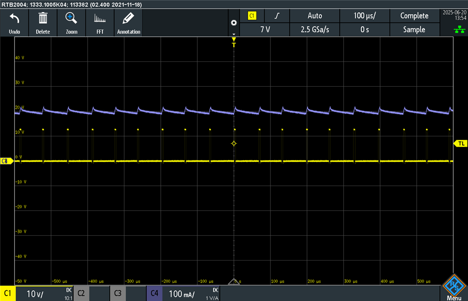

    Was this current waveform or voltage waveform when motor is in static conditions (hold current)? What was the microstep setting used? Voltage waveform will always be a rectangular waveform with tON and tOFF that matches with the ITRIP current regulation. It also depends on the indexer position when the motor is stopped with STEP = low. See below capture of coil A current blue and AOUT1 voltage yellow waveform for the DRV8434A.
    With STEP at 2000 PPS 1/8 Step mode:
    Correct, this should not be OL issue. It looks like stall detection was not properly set. Can you set to Stall Threshold mode STL_MODE = high and TRQ_CNT/ STL_TH pin to 0 V? Although nFAULT was reported that should not have affected motor operation as STALL detection is for report only. Thank you.

  • Hi Murugavel,
    The above measurement was when motor was stepping with 1/16th step.
    I then set to Stall Threshold mode STL_MODE = high and TRQ_CNT/ STL_TH pin to 0 V, and measured current thru one coil while stepping at 1/16th. Motor is stepping even thou current signal (176mA peak) doesn't look like yours above. Any idea why current during 1/2 period is toggling between 0 and sine-wave?
  • Hi Mats,
    This looks like a current probe issue. What were you using for the current probe? Perhaps you may have to reduce the bandwidth for measurement.
    Regards, Murugavel

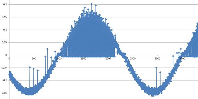

    I'm not measuring with an inductive probe. I inserted a 1ohm resistor in each coil circuit and measure the voltage on each side of one the resistors. Then I do the math in Excel to get the voltage over the resistor which (by knowing the resistance) gives me the current.
    And I can see in the exported voltage values how voltage is jumping back 'n forth between 0 and sine-curve voltage. So it seems like something in the driver is reacting os soon as current flows in one of the directions.
    I have reduced sampling 10 times and the pattern remains that current in one direction works but not the other.
    Mats
  • Hi Mats,
    Understood, thanks for the clarification. While measuring the voltages to perform math and extract the current samples accurately, the tON and tOFF PWM cycles must be considered and subtracted correctly. These PWM toggles are reasonably fast edges requiring very fast sampling to make sure they're not missed and properly subtracted to get a clean current waveform samples. I think this is why the computed current waveform looks contaminated. It is not possible to have such current waveform artifacts. Ofc there may be other reasons such as high back EMF causing distorted sine wave. I do not think this is the actual current waveform in your system.
    Perhaps, a solution could be to perform LPF (low pass filter) with both voltage samples across the 1 Ω resistor to get rid of high frequency alias artifacts and then perform the math to get the filtered current waveform. I'm pretty sure the current waveform in your setup will look to be a reasonable sinewave similar to the capture I shared.
    I have had decent current waveforms in the past with these low cost current probes, https://www.amazon.com/dp/B06W2KFZLW?ref_=ppx_hzsearch_conn_dt_b_fed_asin_title_1 and https://www.picotech.com/accessories/current-probes/60-a-current-probe-bnc.
    Regards, Murugavel

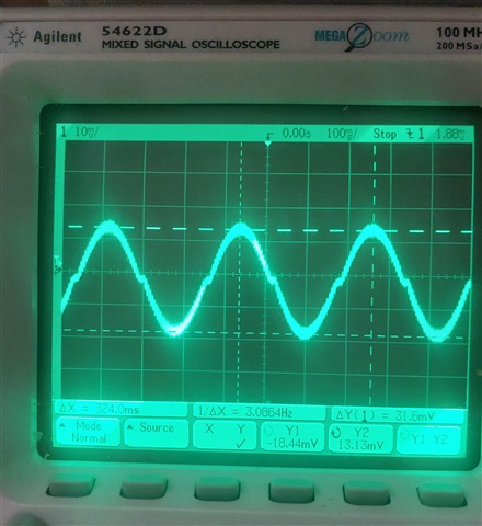

  • Hi Murugavel ,
    Got the Hantek CC-65 probe, and now I get this waveform when motor is doing 16th steps with 5ms/step. Probe is set for 100mV/A -> Peak current 316/2mA = 158mA. Curve looks good, so still no explanation why nFAULT and STL_REP immediately goes low when nSLEEP goes high.
  • Hi Mats,
    Thanks for the update. The current waveform looks good.

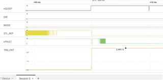

  • Hi Murugavel,

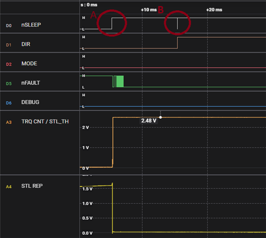

    I now set STL_MODE = GND, with motor having a good distance to end position.

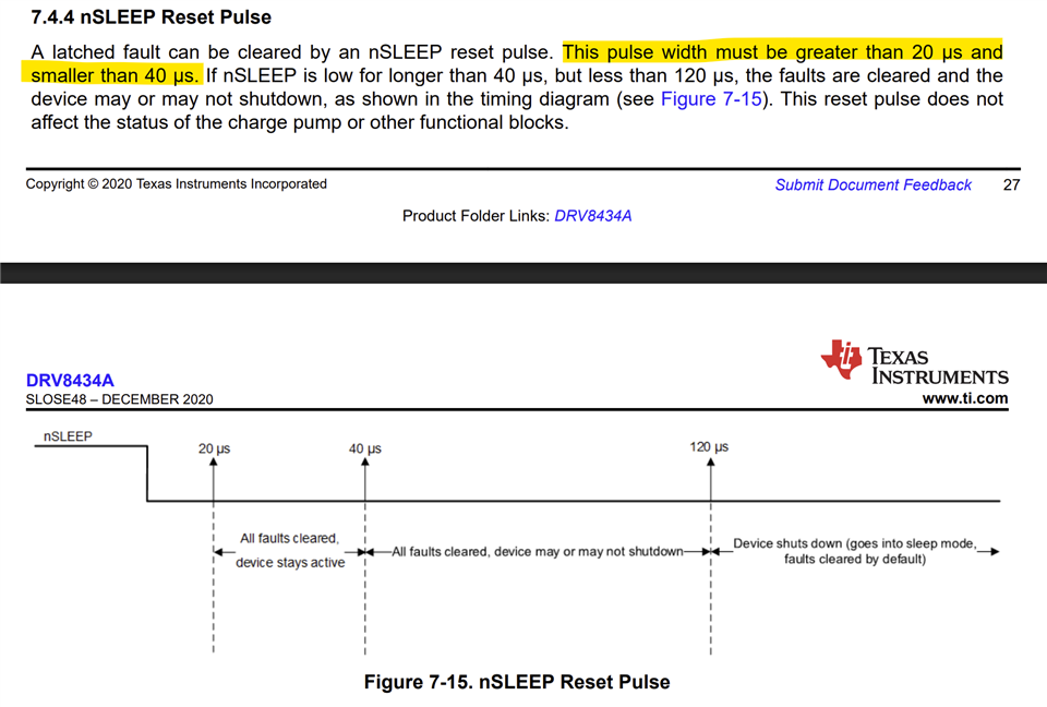

    At (A) below nSLEEP is set to 1 (when MODE already is set to GND). nFAULT almost immediately drops to 0, TRQ_CNT/STL_TH goes to 2.48V.
    At (B) a nSLEEP reset pulse acc.to above is issued (31,04us) without any efffect on nFAULT

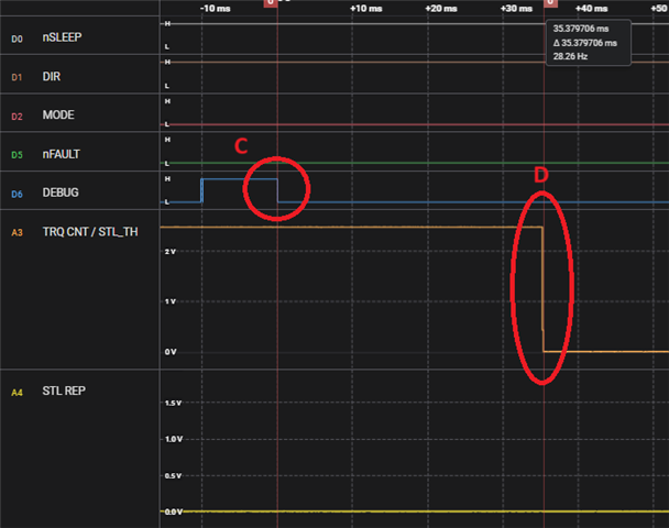

    At (C) stepping starts (5ms/step)
    At (D) 35.4ms after (C) which corresponds to 7 steps then TRQ_CNT drops from 2.48V to 0V

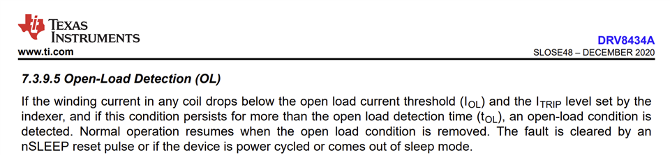

    What I don't understand is why nFAULT goes active almost immediately after reset before any steps has been made indicating "a fault is detected".
    But what fault? It's not "VM Undervoltage Lockout (UVLO)", "VCP Undervoltage Lockout (CPUV)". And it can't be "Overcurrent Protection (OCP)" since motor is stepping.
    The only case I see is "Open Load (OL)", but measured current 158mA is well above "Open load current threshold" of 75mA. But this value is only defined with "TYP" value. No MIN or MAX. What is MAX?
    And since TRQ_CNT = 0 when motor is running then I have no value to provide as DC input voltage.
    Mats
  • Hi Mats,
    Thanks for the follow up.
    Please try by changing the above sequence from A, B, C and D to A, C, B....... The stepper motor you are using is a high DCR 50 Ω not suitable for stall detection with the DRV8434A. In addition to that 5 ms/step or 200 PPS is too low a step rate to produce a good enough amplitude BEMF voltage to help with stall detection. You could try higher PPS if you can, especially you are in 1/16 step mode, you may need > 1000 PPS perhaps > 2000 PPS to get meaningful torque count voltage. Thank you.
    Regards, Murugavel

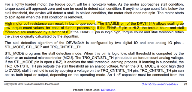

  • Hi Mats,
    You can also try the 8x torque count mode because the motor you have is a high DCR motor.
    Regards, Murugavel
