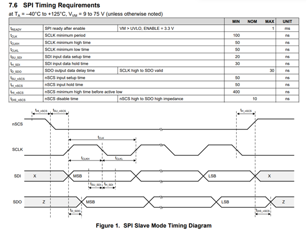

    Also, please make sure you are following the SPI timing diagram outlined in the datasheet
    Making sure to sample on falling clock edge (CPOL and CPHA settings in your code)

    The biggest possibility to me is 0x12D write having much more switching on the SDI line than the 0x400 write.
    Some questions:
    1. How long are the SPI lines on your board? I see that there is some ringing present on your SPI lines, so this leads me to question the timing/integrity as a whole.
    What else could be the explanation for some writes working and some not? It's clearly not an issue with your formatting, as it is able to perform successful operations.
    2. Please provide a zoomed in scope on only the unsuccessful write transaction for further analysis.
